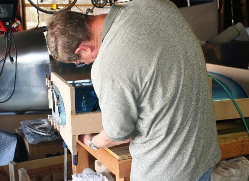

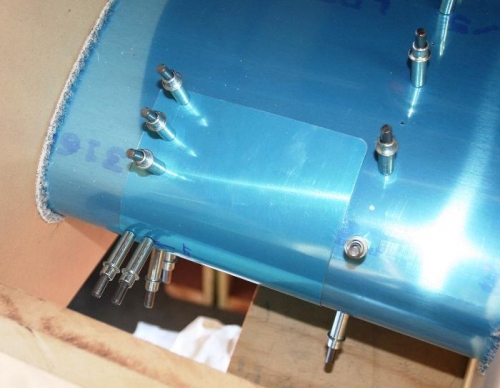

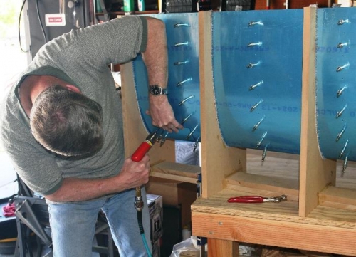

Continued around the leading edge drilling the Stall Warning Sensor mounting bracket attach holes. After the mounting bracket holes were drilled and clecoed I drilled the two holes that define the ends of the slot for the Stall Warning Sensor.
Drilling the Stall Warning Sensor Bracket Mounting Rivet Holes
Drilling the Two Holes That Will Define the Location of the Slot for the Sensor
Clecos in the Holes in the Top of the Leading Edge for the Stall Warning Sensor Bracket
