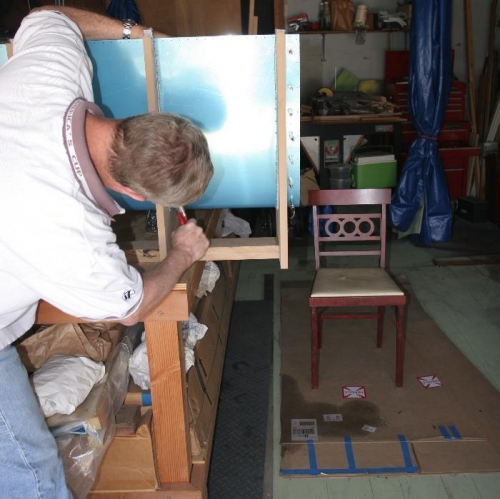

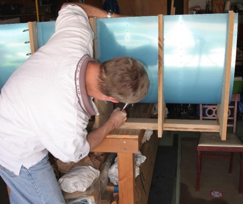

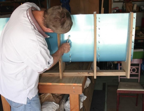

Clecoed the two outboard Leading Edges together so the ribs and skins could be match drilled. The jig made this much easier than I had found it previously when I tried to assemble the Leading Edges so I could identify where the rivet holes would be in the W-408-1 Rib and flute between them.
