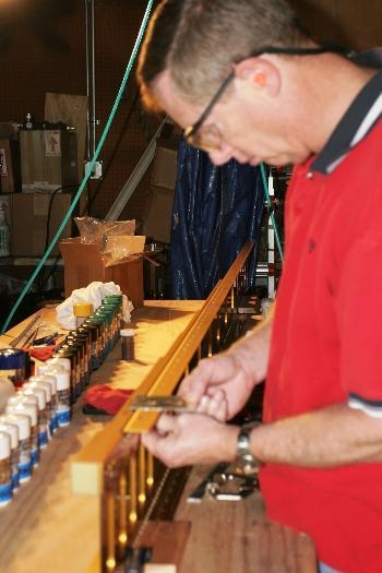

Finished drilling the Left Wing Spar flanges and then moved on to the Right Wing Spar. One of the things I've been doing as I complete each counterbore is test the fit of a piece of aluminum the same thickness as the leading edge skins. I dimpled the piece of aluminum to duplicate the dimple the leading edge skin would have. As shown in image 2, after completing each counterbore I place the skin sample onto the countersink and drop a screw into the hole. I hold the screw from below, pulling down on it to simulate the screw having been torqued and then see if there is any loosness in the sample. I also check to see that the scew head is flush with the skin surface. In image 3, I'm showing the countersink tool installed from the underside of the flange.

Checking How Well the Screw Countersink Matches
