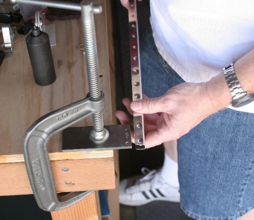

Some parts are just too narrow to dimple using the "standard" tools so I ended up making one to dimple the last two holes on the R-903 Tip Rib, the R-904 Bottom Rib, and the E-703 End Ribs.
Tool I Made to Dimple R-903 Tip Rib

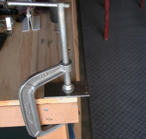

Setting Male Dimple Die

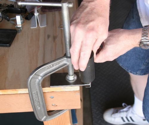

Resulting Dimple
