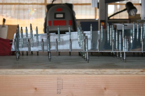

Clecoed the Rudder Skins to the Skeleton today and learned that I need to trim the rudder skin stiffeners a bit more because they are preventing the skins from coming together at the trailing edge.
Cleco'd Rudder Skins to Rudder Skeleton
Gaps in Trailing Edge - Must Trim Stiffeners

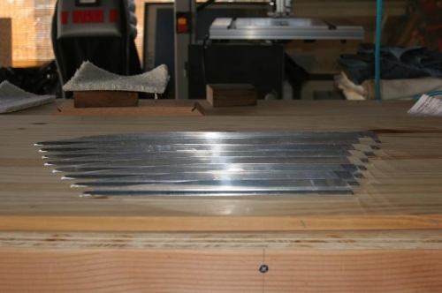

Re-worked Stiffeners
