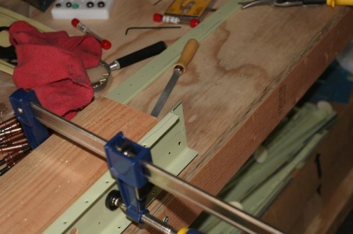

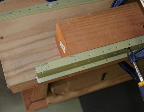

The drawings show that the lower flange of the rear spar needs to be trimmed to provide clearance for the control horns on the elevators. Rather than wait until the rear spar has been assembled I elected to do the trimming before riveting the assembly together.
Marking the Trim Area
Drilling the Radius
Drilling the Radius
