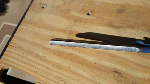

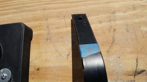

The Tail wheel we ordered has a 1 1/2 " spring. Our tail wheel mount is built for a 1 1/4" spring. So I had to carefully grind and file down the spring to meet the proper width. 1 Hour and twenty minutes later, Voila! Its now 1 1/4”. A little polishing and some epoxy paint and it is ready to install.
Careful scribing
Careful scribing
slow steady grinding and filing
