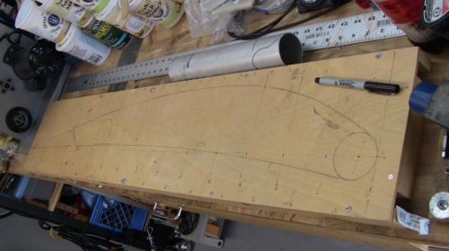

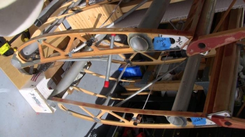

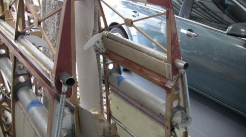

Completed the flap and bearing install this morning. Mission accomplished. Started work on the wingtip form jig. I have to think this one out carefully. Measurements have to be spot on. I have to cut two 5 inch sections of the old spar and split them in half to fabricate inner sleeves and fabricate draw blocks to keep the 1/2” tubing from kinking. Also need to fabricate gussets and think on the transition from the 2 1/2” spar to the 1/2” wingtip bows. I have a rib template drawing to use to layout my dimensions and check fit and placement of the jig components. We hope to get the wings to the airport in about two weeks. I hope I can finish the wingtips in that time. If not, we will have to make other arrangements to transport the wings to the hanger.
Flaps complete
Flaps complete
Wingtip construction begins now.
Wing rib template for jig fabrication
