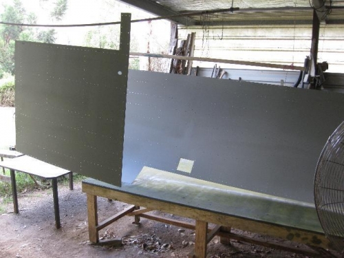

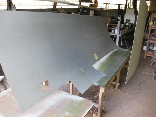

Priming the inside surface of the bottom skins
Today I removed the bottom skins and deburred all rivet holes. (no small task).
I then prepared the inside surface for priming and applied the primer.
I then deburred all holes in the wing framework, bottom skin areas, and did a final clean out and inspection of all bolts in the wing area.
Replaced the skins ready for final rivetting
Heading off to Africa for the next 7 weeks so no work for a bit !
Bottom skin primed
