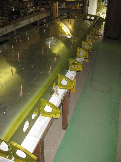

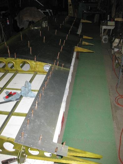

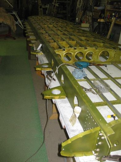

Right side wing.
Yesterday I completed drilling the top skin for the 1/8 rivet holes then removed the skin to deburr and etch prime the inside surface.
Before repositioning the skin, Today I attached the leading edge ribs
I then re-positioned the skin ready for rivetting.
