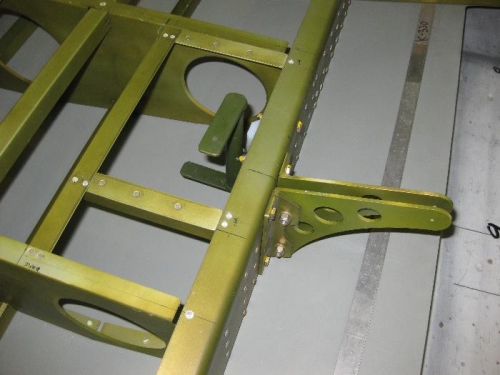

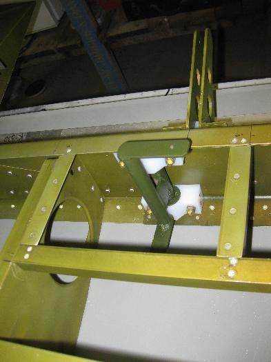

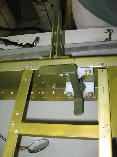

Access panel supports to underside of left wing.
I decide not to use the 0.016 'U' channel and instead used the 3/4 X 3/4 X 1/16 2024 angle to form the support framework for the access panels.
I will use plate nuts for the access panel screws
