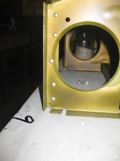

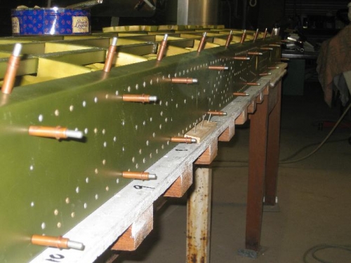

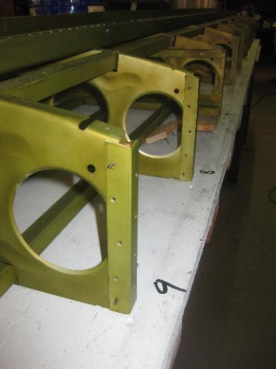

Stared the day by riveting the wing rib attachment angles using solid 1/8, then repositioned the fron spar for the final time. Drilled and countersinked the holes for the rivets in the spar cap, then set these rivets.
Then made up timber craddles matching the curved of the wing top and turned the structure over to sit in these craddles so that I could drill & dimple for the rivets fixing the stringers in the wing underside.
Rib attachment angles back in place
1/8 Solid rivets used to fix angles
Front spar final instal
