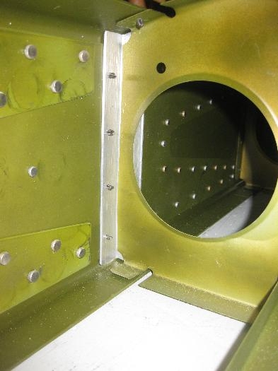

Today I made up the five short pieces of 3/4 X 3/4 X 1/16 angle attachments between the ribs that I cut back due to the added thickness of the spar due to the additional reinforcing plates that I have added.
After cutting the angles, I then reinstalled the spar onto the wing ribs and drilled the fastening rivet holes before removing the angle for deburring and etch priming.
Typical angle connecting ribs to spars.
