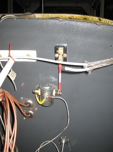

Positioned the continuious duty relay on the forward face of the firewall along with the shunt.

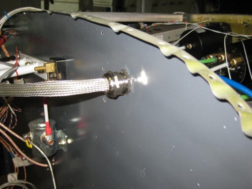

Also ran the 8# wires from the Primary Buss to the shunt and shunt to the relay and the 8# Alternator wire to the Alt CB and then to the primary BUSS.
Shunt & Continuious duty relay
Fully Shielded
Fully Shielded
