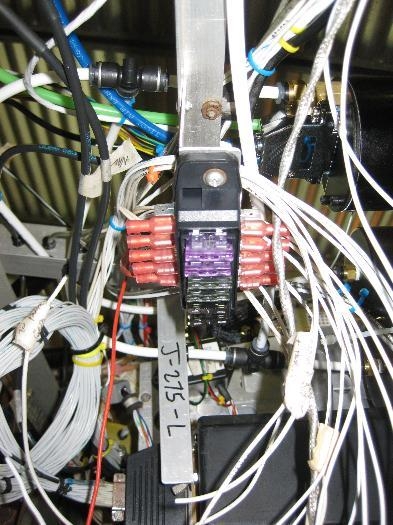

Brief Description:  Plenty of circuit & wiring protection with fuses e
Over the recent few days I have managed to add another 6 fuseable links between the GPS, D6 EFIS, Transponder, Encoder, ADF & Com 1.
All are out of reach from the pilot position,being under the dashboard, something that I am quite happy about because when or if something electrical ceases to function either because of a short circuit or some other melt down, the last thing it needs is a reset button on the dashboard.
Just finish the flight without it and work out the problem later is the safest and best option.
Fuse panel and power ditribution buss on the right side of the panel

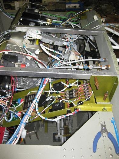

Slowly becoming a little more tidy

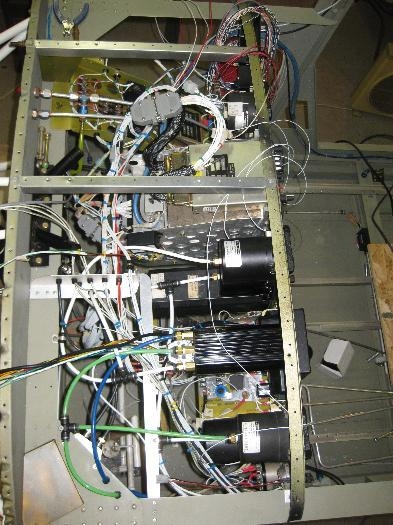

Fuse panel that is easily accessed from under the dash.
