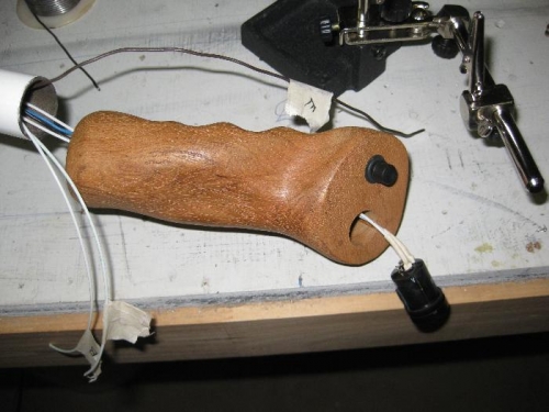

Brief Description:  Stick grip PTT & Trim control wiring

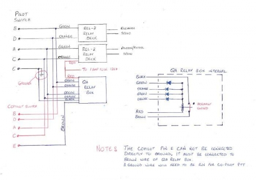

I managed to get a local aircraft radio shop to give me a schematic of the reqired trim servo priority relay circuit that I will need to make up to allow the Pilot to have priority over the trim servo inputs and to also protect the circuits from conflicting inputs.

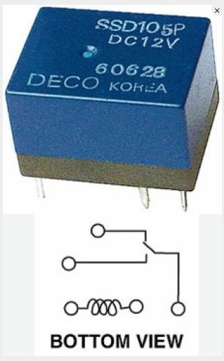

The A/C radio shop gave me a quote of about $270 to make up the relay control, which I declined, and headed down to the local Jaycar outlet and purchased the 4 of 1 Amp -IN4007 Diodes & the 12 volt DC NC (normally closed) minature relay, all for about $6.00.
Back at the workshop, I started, one wire at a time, from where the input commences.
The penalty that I am paying for being very slow at doing this work is more than offset by the satisfaction and understanding gained.

Start of the PTT & Trim wires
The plan
The plan
The crucial item.
The crucial item.
