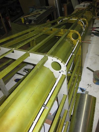

Today I decided that before riveting any skins onto the fuselage that I would run the static system tubing, the rudder cables and the tail light wiring.
During the building of my RV4 some years ago I learnt that leaving the wiring to last was a mistake, so this time I've started a little earlier and at a time when access is more convenient.
Also ran the rudder cables through the guide blocks and installed a chaffing cover of plastic tubing on the cables where they run past the tail pull handle.
I would suggest that Class Inc incorporate some assembly recommendations and or details with regard to wiring consideration and time allowance in the assembly blurb.

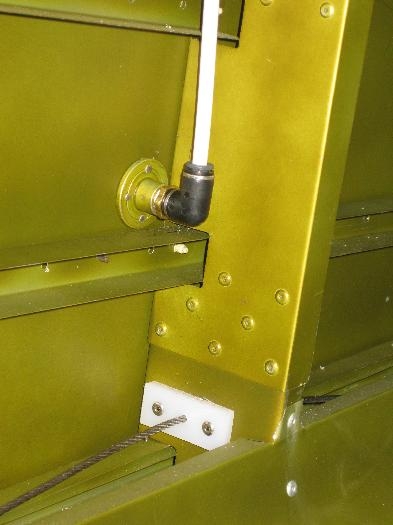

I purchased and used the Safe Air Pitot and static ports kits, well worth the few bucks and superior fittings over those supplied by Vans.
Starboard side static port.

Static tubing and the tail light wire
Much easier doing it now.
