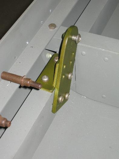

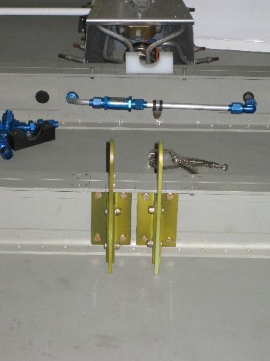

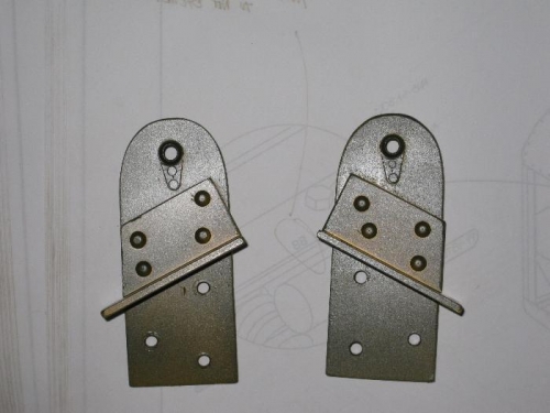

Seat belt attachment points
To fit the centre seat attachment points I dilled out 8 of the sub frame rivets and used AN 3 bolts in these locations to mount the brackets on the subframe cross member.
Rear seat belt attach bkts at cabin sides
Front seat centre belt attach points
Rear seat left side attachment point complete
