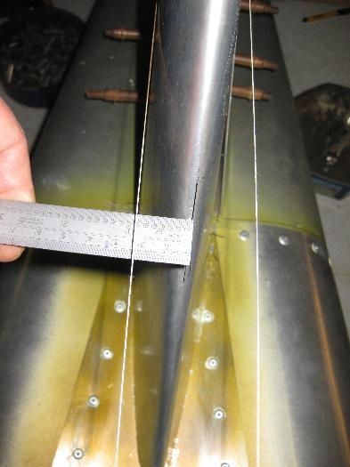

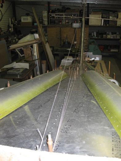

Vertical Stabilser leading edge
Set up string lines offset 20mm to the left of centreline at bulkhead PA01 to establish the suggested amount of offset for the vertical stabiliser to suit my engine.
Fitted, trimed and drilled the leading edge skin.
Checking the Vstab offset
string lines.
