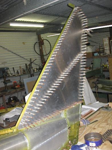

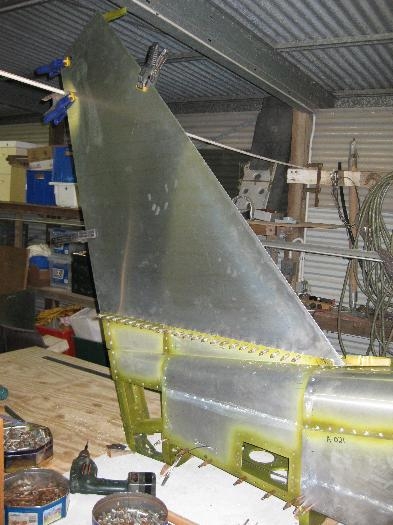

Started on the Vertical stabilser skins.
The frame work for the Vstab doesn't feel as ridgid as I would have expected and constant checking of the alignment whilst heating the skins and drilling rivet holes is required.
Not enough detail in the drawings or assembly blurb in relation to the top of the Vstab and rudder horn interface.
Bottome edge first.
Bottome edge first.

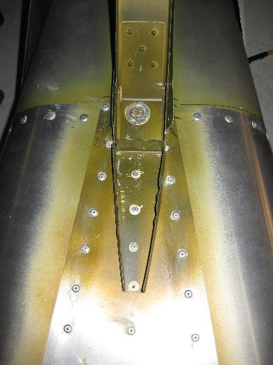

Offset the leading edge bottom rib the suggested amount to the left of centreline
Left side fully drilled.
