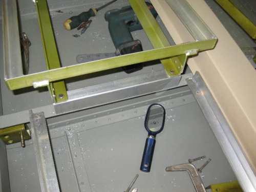

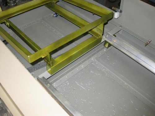

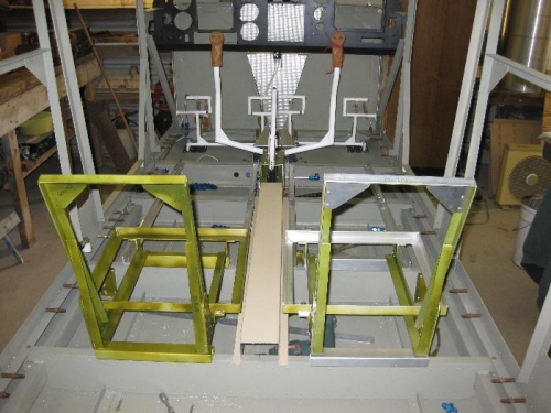

Raising level of rear seats
In order to slightly improve the rear seating leg room and to provide clearance for the aux. fuel tank installation, I spent the day fitting aluminium rectangular tube packers beneath the seat frames.
Right side rear seat frame
Position of the rear seat frames
Left side rear seat frame
