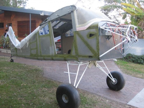

I the removed the wings and repositioned the Fuselage back inside ready for the engine installation.
Outside for the secong time this month

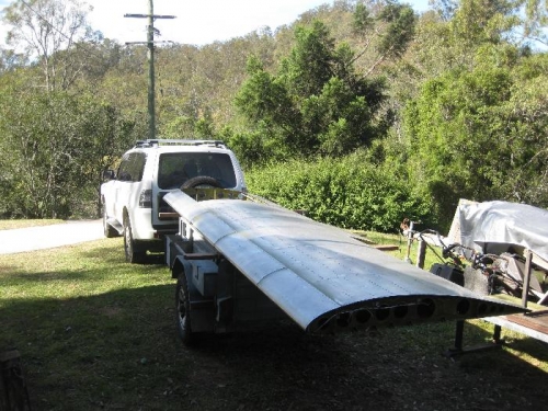

Reloaction a wing to the paint shop

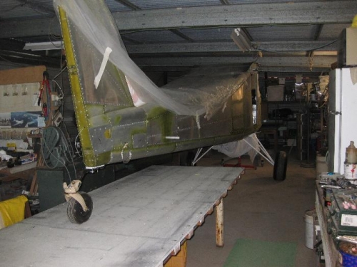

Back inside ready for engine fitting & cowls.
