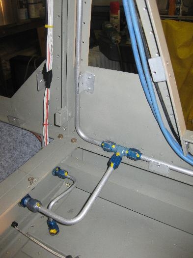

After completing the internal linings on the cabin right hand side, today I decided that it was time to complete the fitting of the fuel lines for the final time.

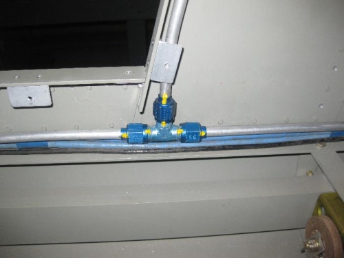

After final tightening of the fittings I used Torque seal to show that final tightening had been done.
To check to see that the system had no leaks I blanked off one of the fuel tank pick up lines and then sucked on the other one. After generating as much suction as I could, I placed my tounge over the end of the pipe and held the suction for about 1 minute. Bingo no leaks. I did the same thing with the fuel valve opened to test the lines through to the firewall.
Torque seal on the fittings to show they had been tightened

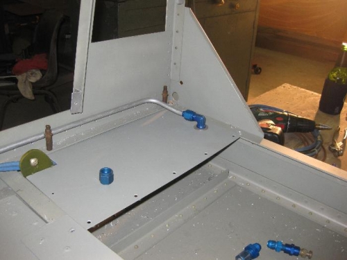

Line running back to the right side fuel drain low point.
