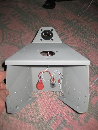

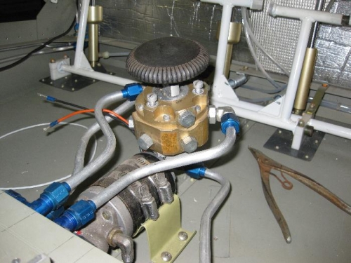

Yesterday I once again turned my attention to solving the problem of making a fuel valve selector handle and ended up modifying a trim wheel from a Baron that I had parted out years ago, addapting that to fit the spindle of the selector valve.

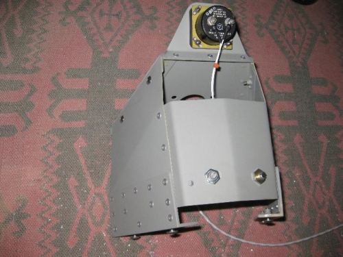

I also painted the support bracket housing and installed the auxillary fuel guage and the variable resistors required to make this 28v guage work with the sender unit that I have installed in the auxillary fuel tank.
I ordered the fuel valve placard and will install the assembly for the final time when this is received.
