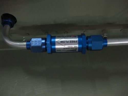

Brief Description:  Fuel line non return valve
The Electric fuel boost pump I've decided to use had me concerned in case of failure or blockage due to seizure so I installed a bypass fuel line with a non return valve so that the engine driven pump can draw fuel past the electric pump at any time.
Electric Pump bypass line non return line
