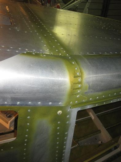

Big day for a change and a significant milestone.
Having satisfied myself that just about everything is made up inside the cabin that required access from the cabin rear opening, I repositioned the Cabin and rear Fuselage together, installed the side skins and started placing the rivets whilst heating the skins.
All rivets dipped in Duralac.
It is now one big bit of cabin & Fuselage and getting very heavy.
Roof joint and the corner splice.

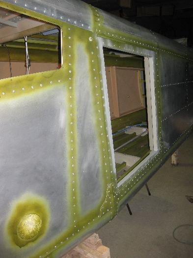

Right side
Right side

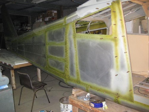

Cargo door side
Cargo door side
