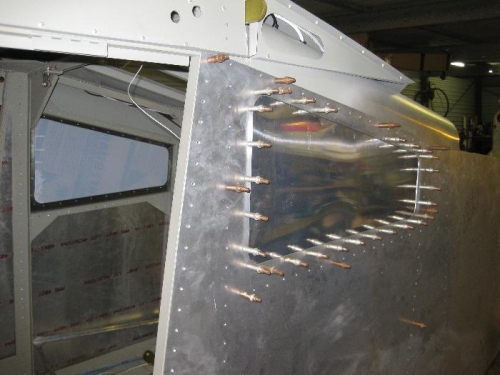

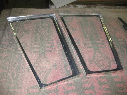

Today I finished makling up the frame linings for the rear seat windows and fitting the polycarb windows.
I did not like the thin clear polycarbonate window material supplied with the kit, it was too flimsy and I also wanted a darker tint so I purchase some 2mm locally with a smoke grey tint which will look much better and will not flex of vibrate as much as the material supplied.
I Plan to use this on all the side and roof window openings.

Fitting the left side
Left & Right passenger internal window frame liners
