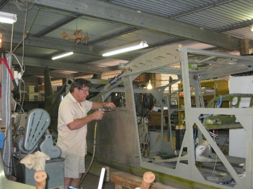

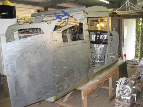

Brief Description:  Cabin side skins
Decided to fit the cabin side skins before carrying on with the internal fit out.
A new sharp 1/8 " drill bit and the air drill is good here to save the battery drill.
A good investment in time to the layout of the rivet lines to avoid the frame rivets pays off.

Right rear skin drilled.
