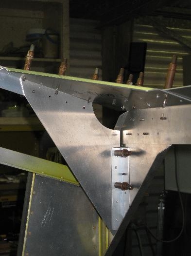

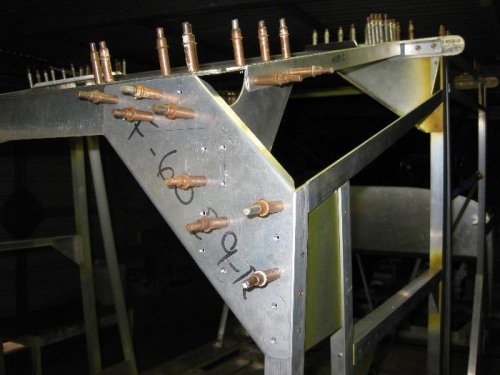

Brief Description:  Rear upper cabin area
Having completed the assembly of this area as per drawings A-C-86 & 87, I did not like the amount of flex between PF 6017 & 6016 and PF 633, so decided to make a stiffening gusset plate joining up between PF 6029 & 6042 and similar for the left side.
I also envisage that the lower area of this plate will serve as the rear upper seat belt attach point for the back seats.
Which reminds me, I searched and searched through the drawings and the manual and found no reference to seat belts! Surely, hard point attachment brackets or lugs should form part of the kit wouldn't you think?
Additional gusset stiffener
