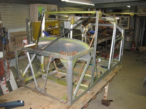

Cabin frame work assembly
Finished the cabin front frame at fire wall.
They felt a little flimsy, so I made up an extra gusset plate between the two at the bottom in order to stiffen this area.
Started on the assembly of the cabin rear upper framework by clamping in place.
Assembled but not fully riveted.
