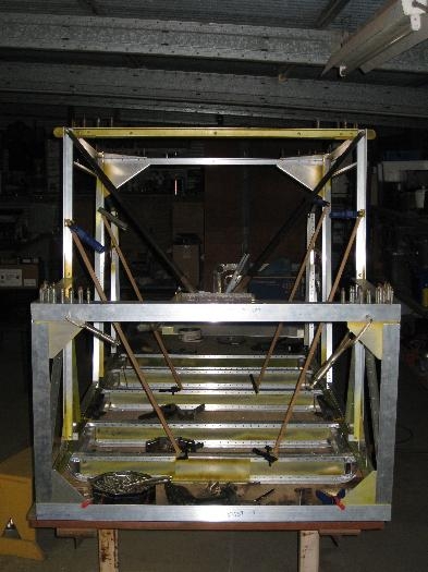

Brief Description:  Upper Cabin framework assembly
Struggled to understand the arrangement of the aileron and flap control fittings in the upper cabin area due to lack of detail and drawings. This is mainly due to the assembly manual referring to components that are not utilised in the L164.
Had to request more detail and photographs of other similar models in order to clarify what was intended.
I would recommend that Class Inc generate a separate manual for each aircraft model and update the drawings (mostly 2002 version).
