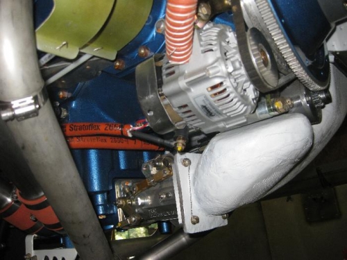

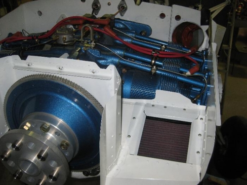

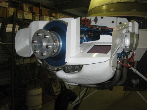

Did a number of small jobs today.
New engine oil (mineral Run In type), and with the lower spark plugs removed, turn the engine over with the start to bring up oil pressure.
Final fitting of the snorkle & air filter. Lock wired the attach bolts at the throtle body.
All it needs now is fuel and it will go.
But before that, I will install the alternate air control cable and complete the baffle seal material.
And , of course, put the prop on !
Snorkle lock wired
Snorkle lock wired
