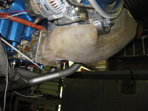

Brief Description:  Fitting the Snorkle duct
The hangover has just about cleared up,( I was practicing for the 31st !), and combined with the hot weather, not a good day to tackle the mod required to fit the snorkle.
I noticed that a number of builders using this Vans supplied item have had to do the same.

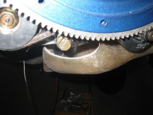

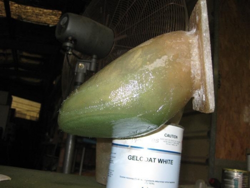

It needed to be cut back where it was hitting the Alternator mount bracket....such is life.
I made up the parts connecting the snokle to the front left baffle plate
I also dismantled all of the front left baffle Quadrant and etch primed the parts in preparation for the finish coat.
Snorkle in situ
Snorkle in situ
Where it had to be cut back
Modification glassed up.
