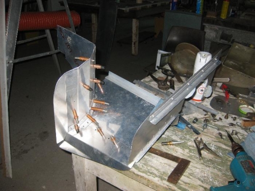

Brief Description:  Forming the baffles into 4 quadrants.
The Baffle kit that I purchased from Vans, whilst it was the wrong one for my engine, it did have all of the bolts and most of the reinforcing plates that are required plus very good detail of the whole installation. Highly recommended.

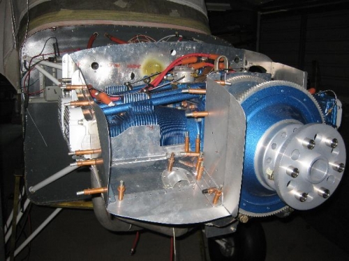

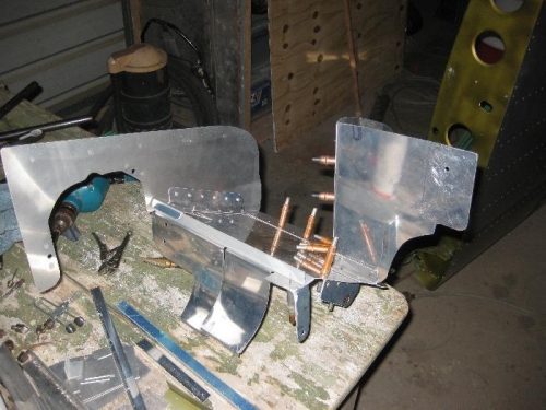

It was only about now that I started to recall that when completed, the assembled baffles are formed into 4 separate and fairly easily removed pieces, as can be seen with the front left assembly in the centre picture below.
I intentionally left the upper edges high for later trimming when I reinstall the cowl,
Hope Y'all have a very Merry Christmas !
Front right side sectiopn
The removed front left side.
Front left.
Front left.
