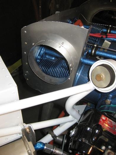

Today I cut the 5" hole in the baffle behind number 4 cylinder and formed the flange to take the scat pipe conecting between the baffle and the oil filter duct box which I had painted yesterday..

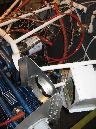

Started on the front left plate where the air filter will go, as I finally decided to use the air filter duct I had preveiously purchased from Vans.
5 " Scat opening behind Cyl. No. 4
Formed from a 2
Formed from a 2" wide strip of .024 6061
Front left plate where the air filter will go.
