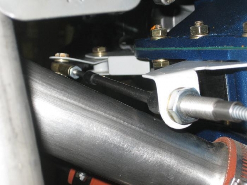

I found some parts that I did not use when building my RV4, and decided to see if they could be used for the mixture control set up.
After viewing someone elses installation on the net, it inspired me to do the same, and guess what? it worked.
Took a few hours of tinkering to get the full range from full rich to idle cut off, but the effort paid off.
Tommorrow I'll be able to place the castle nuts & split pins on all of the moving pivot connections and torque seal the other bolts as I double check the final install.

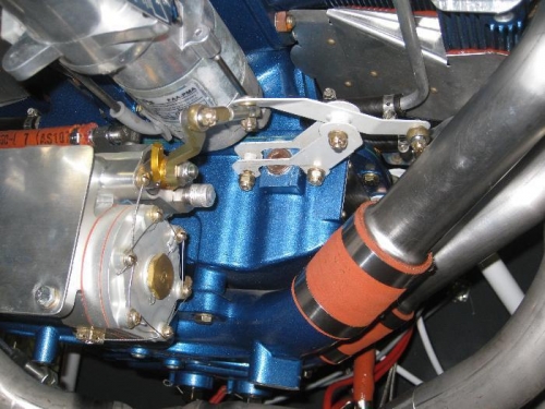

Changed the plug on the front of the sump so that the bracket would fit.

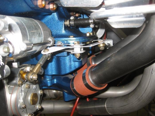

Clearance at the Starter motor was just enough.
