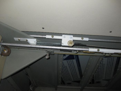

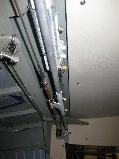

One of the satifying jobs today was to measure and cut the pushrods for the aileron and flap operation and make the connections inside the cabin.
To get the full 30deg of flap down operation, I had to make a 4th flap notch in the flap handle arragement.
Flap & Aileron push rods
Additional notch needed to get 30deg of flap
