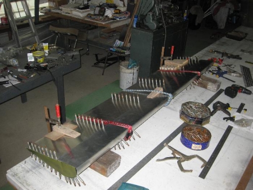

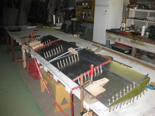

Brief Description:  Final prep of Aileron for riveting

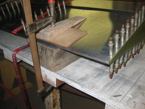

Prior to final drilling of the 1/8 rivet holes I then reassembled the Aileron (or flap) and clamped it to the work table with the estimated amount of built in twist to match the wash out in the wing.
After drilling the 1/8 rivet holes, deburring and interior priming was completed before final assembly and riveting
