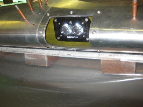

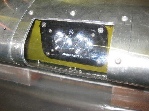

Brief Description:  Landing light cut out in leading edge.
When forming the opening in the leading edge, I used some of the thin clear lexan that was supplied as side windows, cut a piece to size & used a heat gun to get the curved shape.
To hold the lens, I made up an internat backing plate with the plate nuts to take the screws.
Removed & refitted the leading edge skins a number of times, then finally removed them for etch priming internally.
