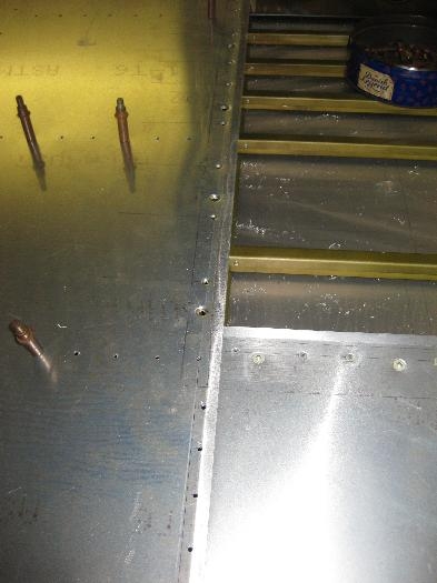

Brief Description:  Left wing fuel tank securing anchor nut locations
A lot of time taken to lay out and position the fuel tank anchor nuts, allowing for the spacing of the gap seal fairing anchor nut spacings and also the skin rivets that need to be dimpled where the tank top skin overlaps the wing skin rivets.

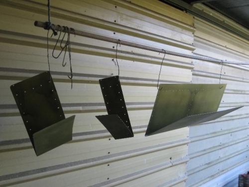

Trailing edge skins primed
Fuel tank anchor nuts locations dimpled

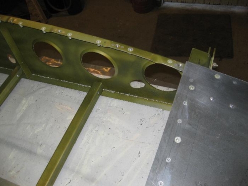

Nut serts installed for the fuel tank fixing
