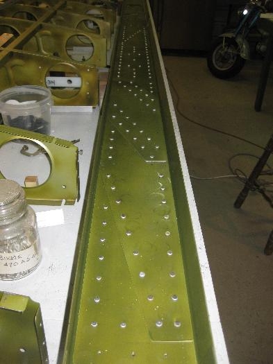

Brief Description:  Riveting Spar backing plates
Slowly getting back into the swing of the building process.

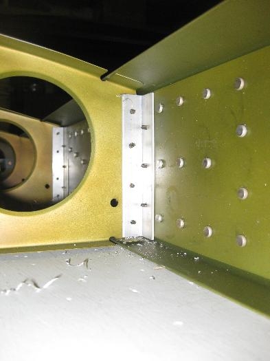

Finished setting the 5/32 rivets through the re-inforcing plates & then repositioned the spar back to the ribs and made up the 3/4 X 3/4 X 1/16 6061 attaching angles for the ribs that had to be cut back due to the added thickness in the spar.
5/32 Solid rivets set

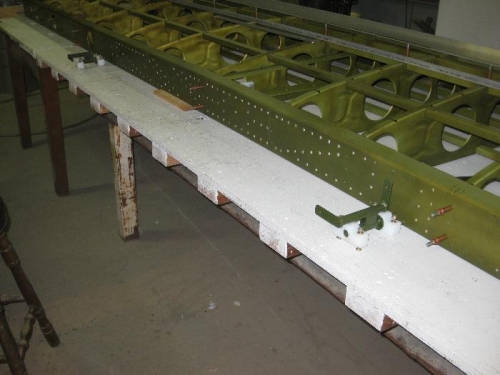

Rear left wing spar back in place.
Attaching the cut back ribs.
