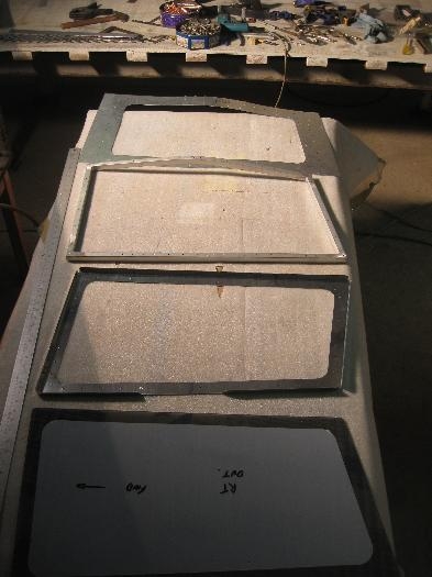

Brief Description:  Right side opening window components
I completed the additional internal lining frames for both left & right opening windows, then cut the 2mmTinted Polycarbonate that I had purchased to replace the thin clear stuff provided with the kit.

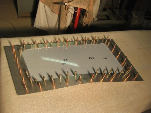

Predrilled all the holes through the skins, polycarb & the internal lining and then redrilled the larger clearance holes through the polycarbnate.
I then etch primed the aluminium parts ready for final assembly when I return from the upcoming SAAA flyin at Narromine NSW.
Assembled prior to priming
