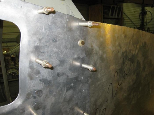

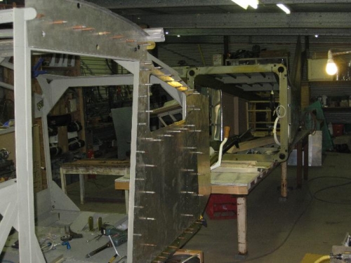

I used the right side skin as a template and marked all holes on the left side, positioned the skin in place with clamps then drilled.

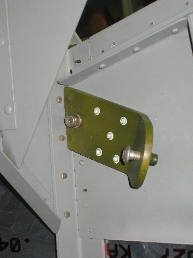

While skin was in place I drilled the hole for an AN3-? Bolt to go through the seat belt attach bracket.
I had forgotten to do this on the right side, so repositioned the right side skin and did the same on that side.
Port side rear drilled
Port side rear upper seat belt attach point
Bolt through the cabin structure and skin
