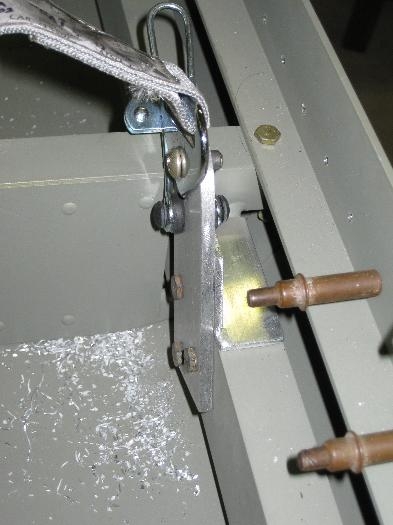

It wasn't until well into the assembly of the cabin structure that I discoverred that Class Inc had not included any info or details about seat belts or the hard point attachment locations.
When I emailed for an explanation and or details I was informed that "this is the builders choice" !!!.
Bloody hell, wouldn't you think that something as important as these would be part of the airframe design, once again the quality of what I've purchased is questionable.
Anyhow, I am beggining to think that my ideas in overcoming this lack of detail and support will generate a better result.

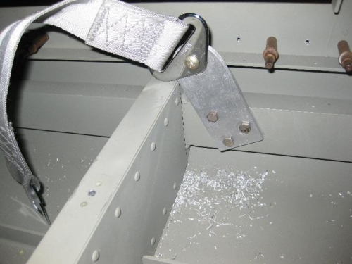

I decided to attach 1/4 inch flat to the sub frame using nut serts with an angle attached as strengthener.
Front seat right side
Angle in place to reinforce the attachment
