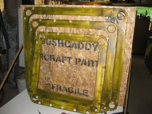

After painting the table and drawing the centre line full length of the table, I then drafted out the frame stations and made up the first support bulkhead at station PA-01 with the correct lean of 2 deg. rearward.

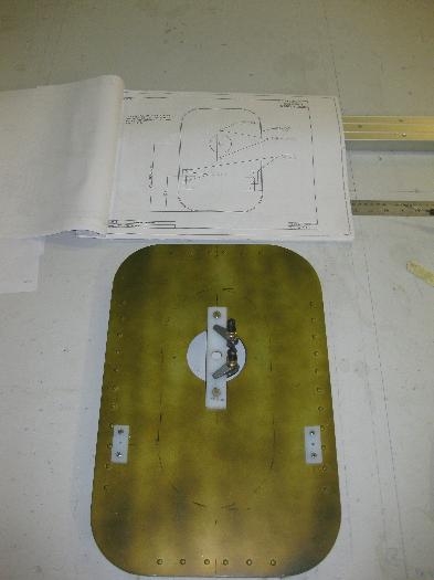

Then primed all frames and installed the rudder cable running block guides and the elevator pushrod guides.
PA-06 with push rod guide and rudder cable guide blocks installed.
Etch primed frames.
Etch primed frames.

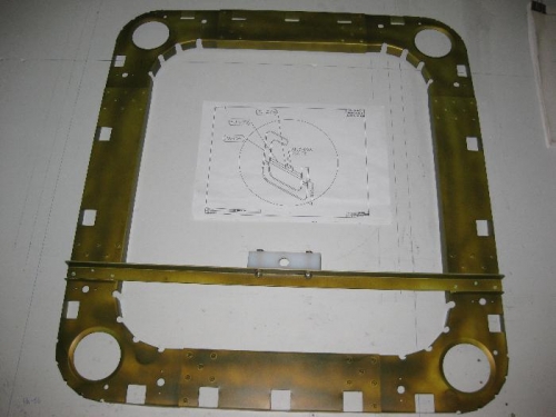

PA-04
PA-04
