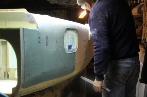

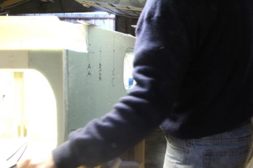

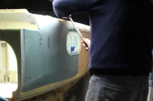

Finished marking upper Fuselage profile.
First cut of profile, left side. Roughed out with Sureform, ground down micro join between side and space until it looks about right, then profiled the rest with a sanding board. Then cut the forward longeron with a power plane (blunt again, it hates flox, by the finish it was more polishing than cutting). Then did it again.
Started right side, light stopped play.
Cutline marked, and positions of templates
