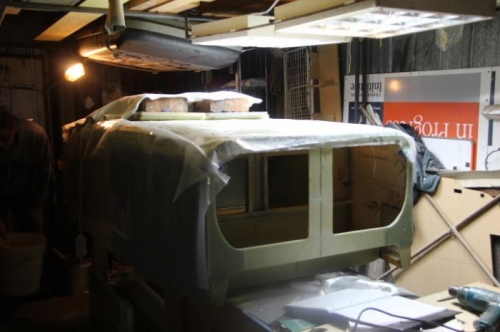

Trimmed edges. Layup looks good. 'Aprons' over side worked well, but packing tape along trim line didn't. Some UNI and a lot of micro overlaid the tape and it was difficult to remove, or see if it had been effectively removed. Had layed the corner of one of the reinforcements over the firewall over the tape, now removed. Will use duct tape next time for a more visible and robust trim line.

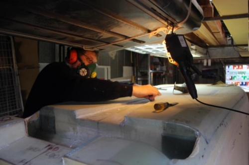

Got some epoxy blobs inside the NACA so sanded them off. Glass had sagged down onto the leading point of the NACA, PIA to grind and sand it off. Next time I would use duct tape at least at the point.
Removing blanky. Note foam under ply over landing brake

Trimming NACA
Trimming NACA
