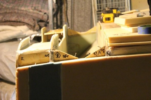

Brief Description:  MLG Bulkhead cross pieces
Cut foam and ply for left side MLG Bulkheads. Ply cross pieces do not exactly match from left to right, but plans say to cut them to FIT, so I am unconcerned. Have seen some pictures online far wobblier than mine...
Installed all MLG ply with flox, secured with nails.
Applied 2 x BID to cross pieces and peel ply.
Bits floxed in and BID on top
