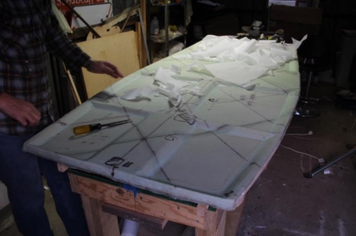

Remove peel ply. Layup was a little rich, but the excess is sitting on top of the peel ply, making it hard to get off. Layup looks nice underneath. Two small voids at the front corners of the seatback marked for later syringe filling.

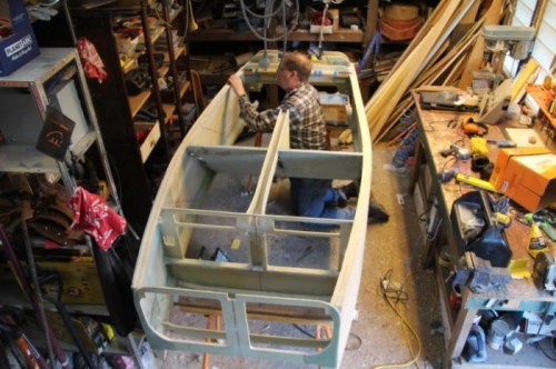

Fixed slat to FWD MLG Bulkhead with hot glue, level with longerons with scrap of 3/4" + 3/8" foam taped over to support bottom.

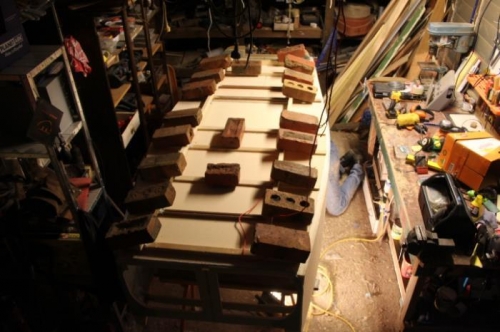

Suspended bottom from roof joists. Mixed up a big bag of flox and applied to Fuselage bottom liberally, lowered on bottom and weighted.
Crawled around underneath cleaning up flox. Tapes a thing for tomorrow. Next morning found a dob of flox stuck to skin behind my ear. Bugger getting it off.
Removing peel ply
Removing peel ply
