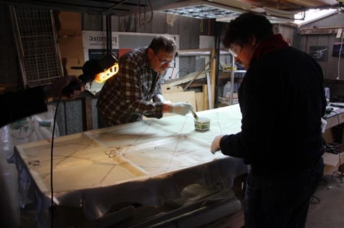

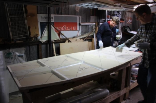

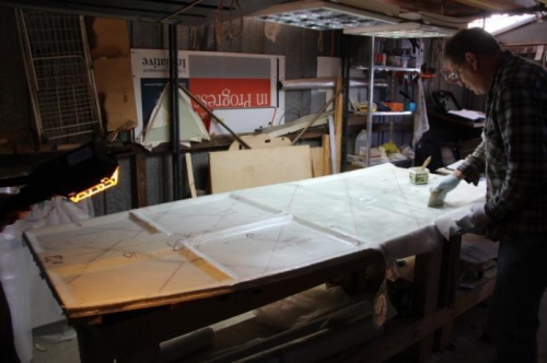

Brief Description:  Layup Bottom interior
With the able assistance of my son Grant applied 2 x BID. Did something different with the peel ply, compared to the sides, precut all the fillets to get the inflexible peel ply to confirm to the flexible BID. Worked well. I marked each point that will need a cut with a marder dot, then cut to that dot from the inside of the angle. All peel ply just lay down where is was supposed to.
Light being held by friend Neil Loft, who came to borrow the welder, but stayed out of professional interest. He's an engineer that builds warships for a living.
Plans have you waiting a couple of hours until the layup tacks up a bit and installing it on the bottom, AND taping! I have read the accounts of those who have done, or attempted this, and they say, "Never again." Being a firm believer in the adage, 'you will never have time enough or luck enough to make all the mistakes yourself,' I will spread this task over at least 3 days, and apply the peel ply overall to achieve this.
